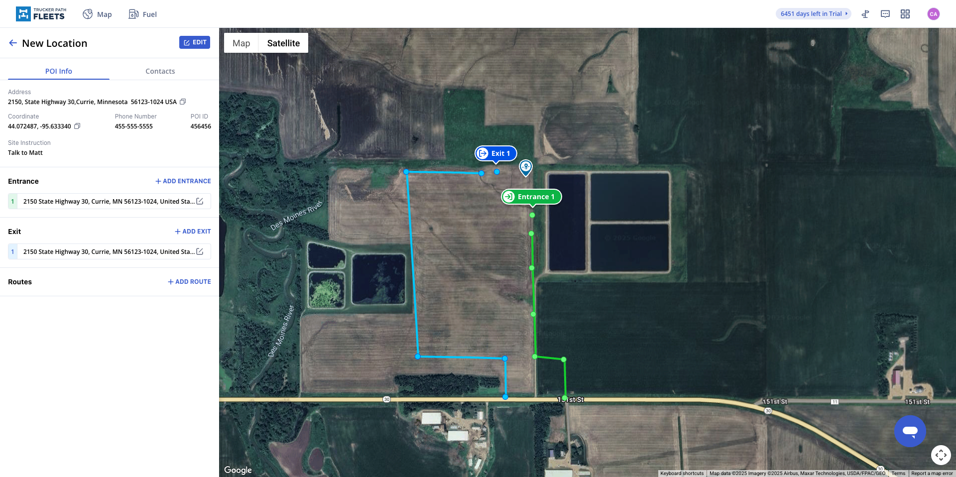

  4. Click the map (then Add POI) or search an address to Add New POI
  5. Be sure to enter:
    Location Name
    Address or LAT/LONG
    Category
    Site Instructions (optional)
  6. Add any entrance or exits paths if needed (you can use road path if roads are available or you can use off-grid path if the roads are not yet available on our mapping layer)
  7. Click Save

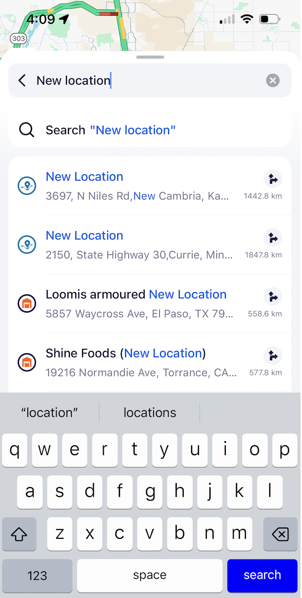

Drivers can access them by:
  1. Opening the Driver App
  2. Tapping Search
  3. Selecting POIs
  4. Choosing the custom location
  5. Starting navigation

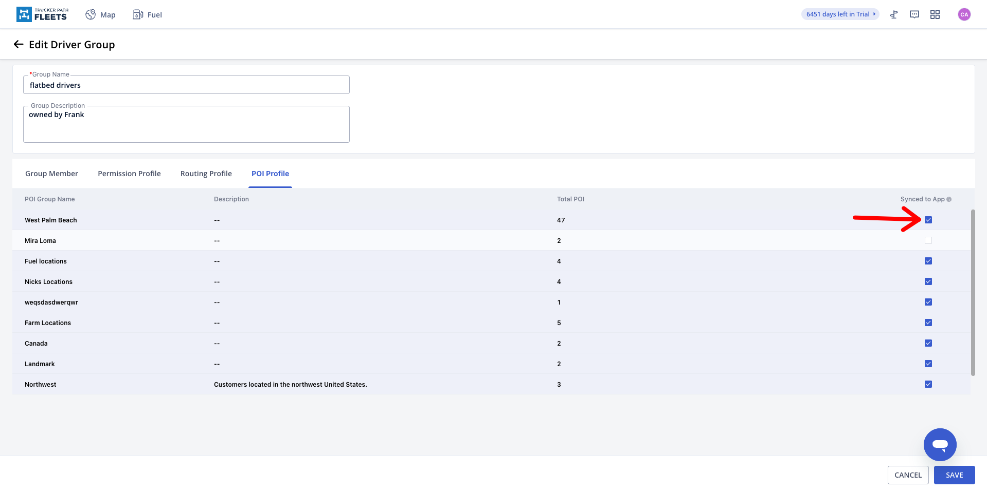

Custom POI not appearing for drivers
  • Confirm the POI was saved to your fleet
  • Ensure the driver is assigned to a Driver Group
  • Verify the POI is synced to the app for that group
  • Have the driver refresh the app or update offline maps
Routing to the wrong spot
  • Double-check pin placement
  • Ensure the pin is placed on the correct road or entrance
  • Verify the driver’s routing profile is correctly assigned
POI not showing up in search
  • Search using only part of the name
  • Confirm the POI category is correct
  • Ensure the POI is synced to the driver’s group
